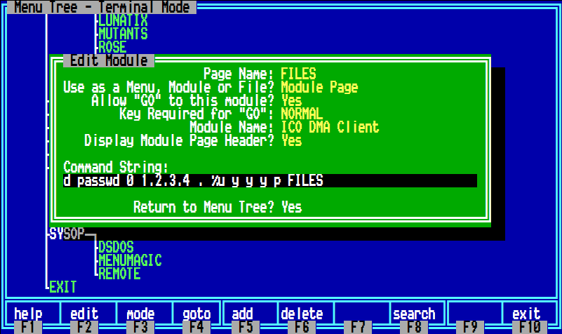

Did you do all the stuff in the TCPDMAIC.DOC that it says you have to? I think its MAXCAT and SGNUSZ or something, one is how many commands you can string together the other is user-id limit. Sounds like MAXCAT from what you are saying though. Make sure both of these are changed on both sides (DMA and WG).
This is how mine looks to go into remote file libraries:
P.S. the #Name to disguise the module name doesn't work on the ICO client
