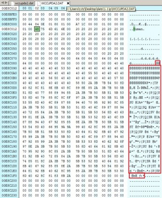

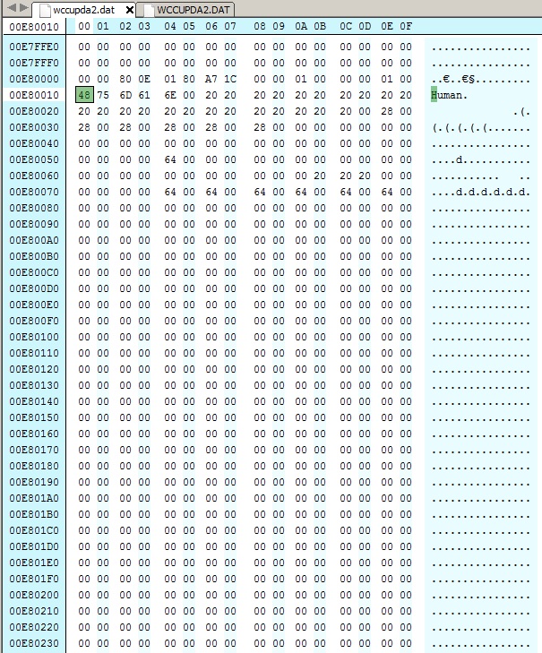

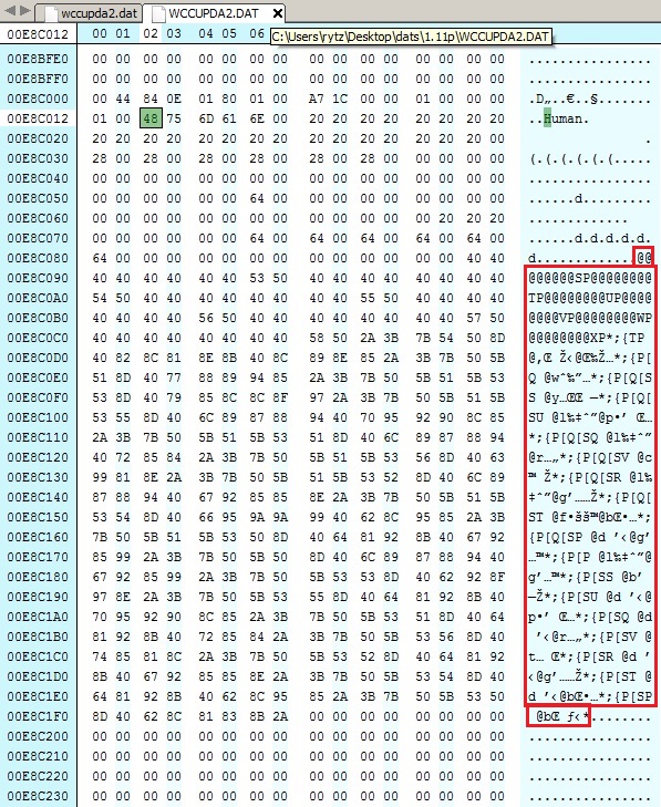

Comparing/hex-diffing the stock WCCUPDAT.DAT with a full-compile update from 1.11p-WG databases shows some interesting differences. The update files are the same up through messages and textblocks. There appears to be garbage data being added right after the first race (Human) where zeros should be.
I debugged the "InsertRace" code in modUpdateFile and checked the values inside "Updatebuf.Data" which all appear to be zero after the 126 chars of data for the race (as it should be). However, when the data gets inserted into the database, there appears to be garbage data from BTRCALL(BINSERT).
See screenshots (filenames are from 1.11p testing):
[ORIGINAL UPDATE] [COMPILED UPDATE]
I thought that maybe it was something specific to my WG code, so I created a full-compile version of 1.11p from stock databases. I did a comparison of that with the stock WCCUPDA2.DAT and noticed the same thing.

I'm still curious about that weird data in the update file, though. syntax - any insight on that or anyone else?
