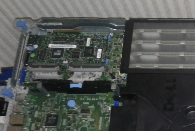

I also removed the DRAC5 remote access card. Its located in the far right side.

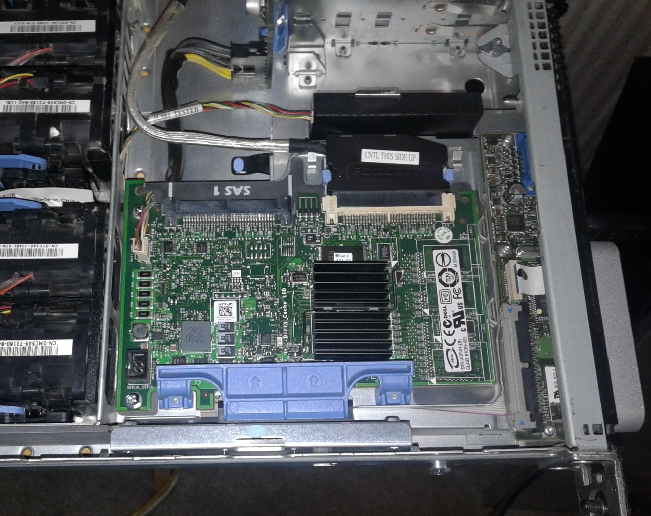

The raid cards latch required a tool to pry it up. At the top of the photo you can part of the backplane where the sas drives connect. That backplane came out easy after a little fuss with that bundle of power connectors.

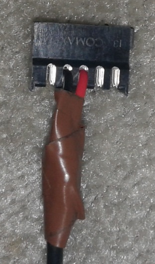

Making the USB to sata power adapter was easy enough.

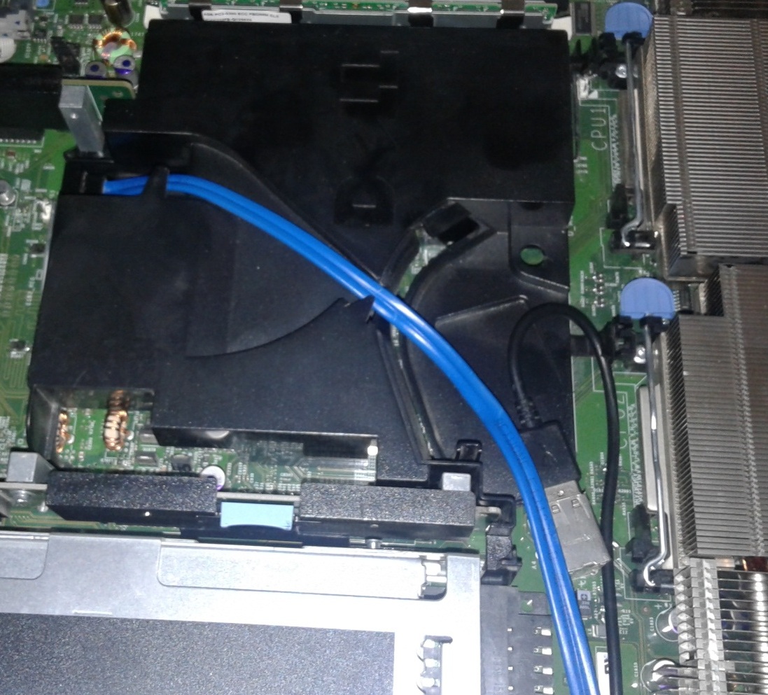

Here is a cover that goes over the N. and S. bridges. I couldnt fit my little ssd drive in that area by the USB, so I hard to route it all back over to the front.

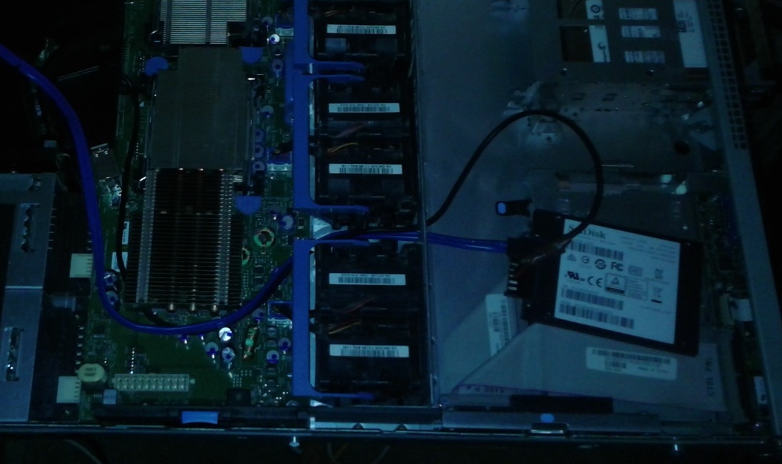

I went around the 2nd processor and through the same access hole the original power to the backplane ran. The drive sits well enough in the raid cards area. Under the ssd drive sits two ribbons. One is for the CDrom and the other for the power/front panel display.
