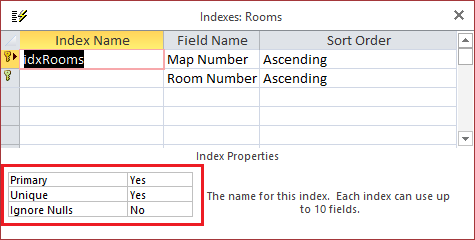

2) You may want to set primary keys in Access before the migration as well. You can also do it after though. You would go into each table's properties --> Indexes --> Set the index to "primary" and "unique". The rooms and textblocks would have two fields for this:
