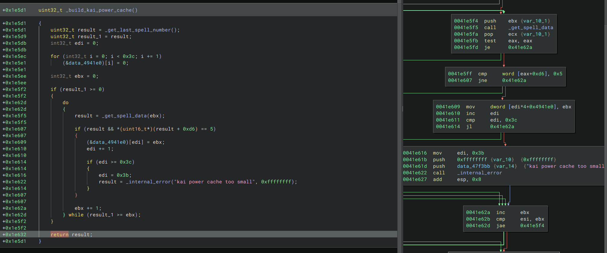

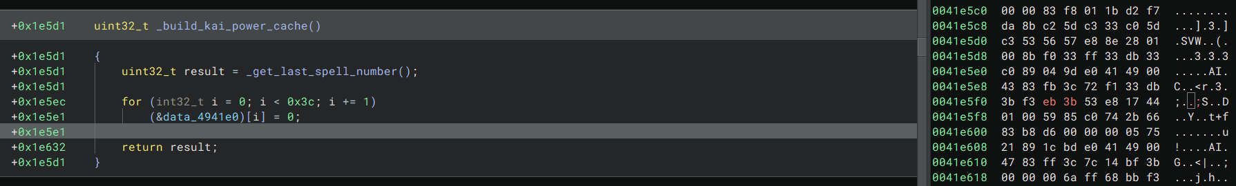

Disables the population of a cache of a maximum of 60 kai spells:

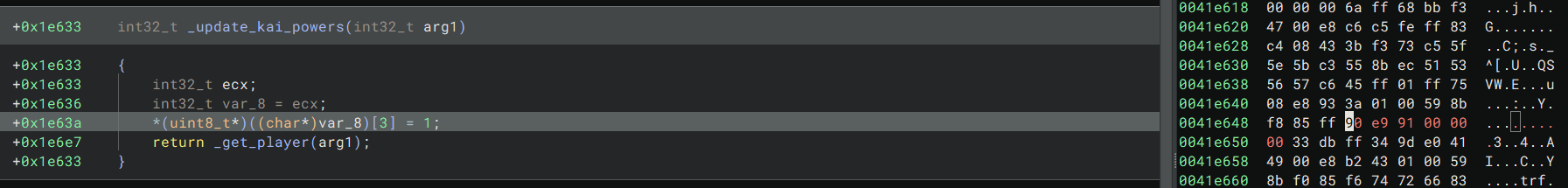

0x0001dbf2 : 723b => eb3b
series of hex just before the offset: 89049de04149004383fb3c72f133db3bf3

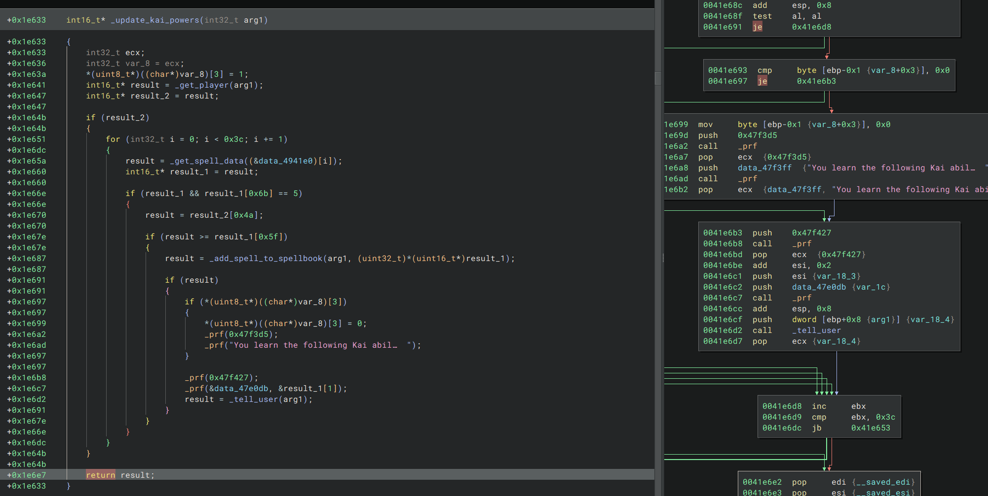

Disable the auto-learning of spells from that cache of kai spells:
0x0001dc4b : 0f84 => 90e9
series of hex just before the offset: c645ff01ff7508e8933a0100598bf885ff
