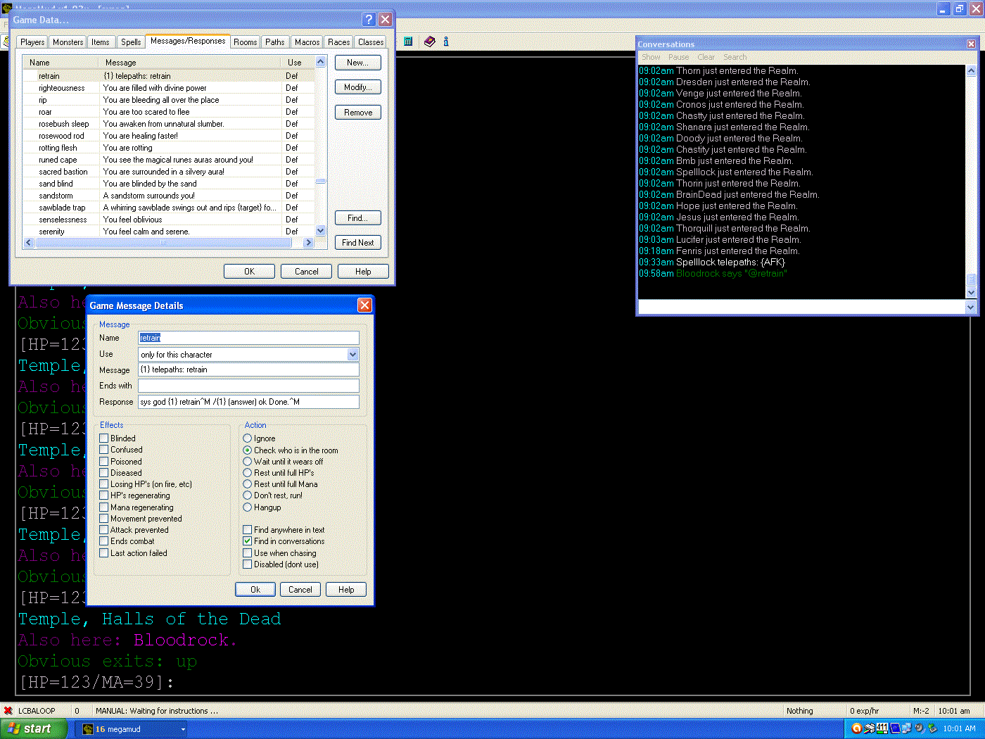

First off can anyone post instruction on how to set up mega for a heal bot, retain, add life, etc? Ive never done it before but my users are requesting it.

as for your bot i attached a screen shot hope it helps
