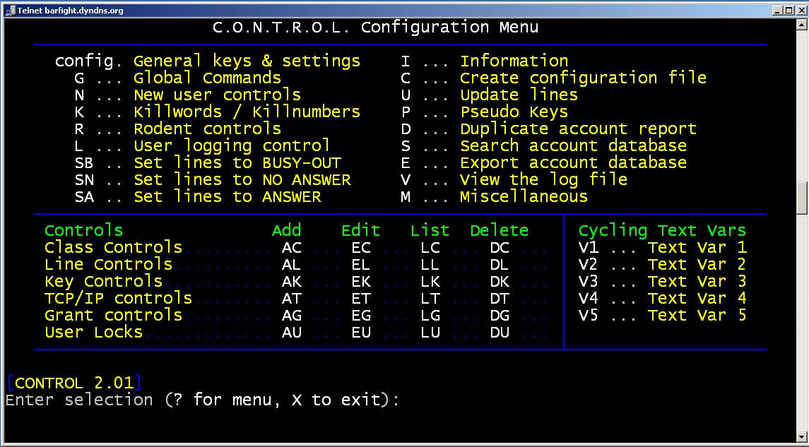

Re: Dialsoft Control
Attached screen shot of main menu to help...
- Attachments
- Dialsoft Screenshot
- dscontrol.JPG (134.71 KiB) Viewed 24367 times
Google cache...
https://www.google.com/search?num=50&hl ... r--3Jm-YgE
leads to--
http://webcache.googleusercontent.com/s ... clnk&gl=us
"Its a setting in control.. Log on to the sysop account go into dailsoft and look around til you find the mud option and set it to user"
and--
"Ok so I figured it out. Had to change the key for class protection. And when I looked deeper at the TCP/IP controls I see that it's far less automagical than I was hoping, unless I'm overlooking something else."
and--
"This is a known problem with WG 3.2 and Dialsoft Control.
Solution to get your bbs back up:
Take Dialsoft Control out of your menu tree and disable it with wgsdmod.
Solution to make dialsoft control work:
Upgrade to WG 3.3 and Dialsoft Control 5.62"
leads to--
and--
and--
Thanks, will disect and report back. I would love to go to 5.62, but lost my keys years ago and am sorta stuck.
