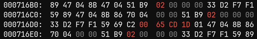

TLDR:
Working within the confines of being able to hex edit this without adjusting the way it's doing the math, there are 4 values to edit and those values will depend on what you want to adjust it by.
  • z = your desired percentage of exp to keep
  • x = 100 / z
  • y = 1,000,000,000 / x
Then hex edit as follows:
  • 0x716B8 = x
  • 0x716CC = x
  • 0x716D7 = y ...but written "backwards" with a total of 4 bytes. 100,000,000 == 05F5E100 in hex and would be written in the editor as 00 E1 F5 05.
  • 0x716E6 = x
The above/attached image is to keep 50% exp...
z = 50 (for 50%)
x = 100 / 50 (x = 2 or 0x02)
y = 1000000000 / 2 (y = 500,000,000 or 0x1DCD6500)
0x716B8 = x (0x02)
0x716CC = x (0x02)
0x716D7 = y (0x1DCD6500) written "backwards" as 00 65 CD 1D (4 total bytes)
0x716E6 = x (0x02)
