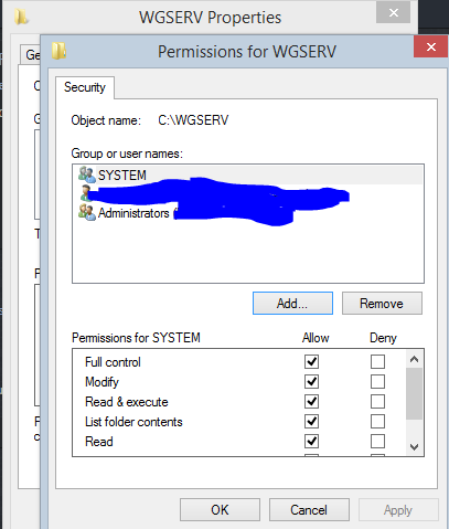

Checked permissions for WGSERV
Any others I should check specifically?

Re: C:\WGSERV\wgserver.exe - I/O ERROR OPENING AUDIT TRAIL (5)
BlackLotus wrote: Mon Dec 18, 2023 3:33 pm Checked permissions for WGSERV
This screenshot only shows permissions for the SYSTEM built-in user account. That may not what the service is running under (and definitely won’t be if you’re launching it manually). You need to also check the permissions on the other users and also look to see what user the service is running as it make sure that user has access to the folder.
