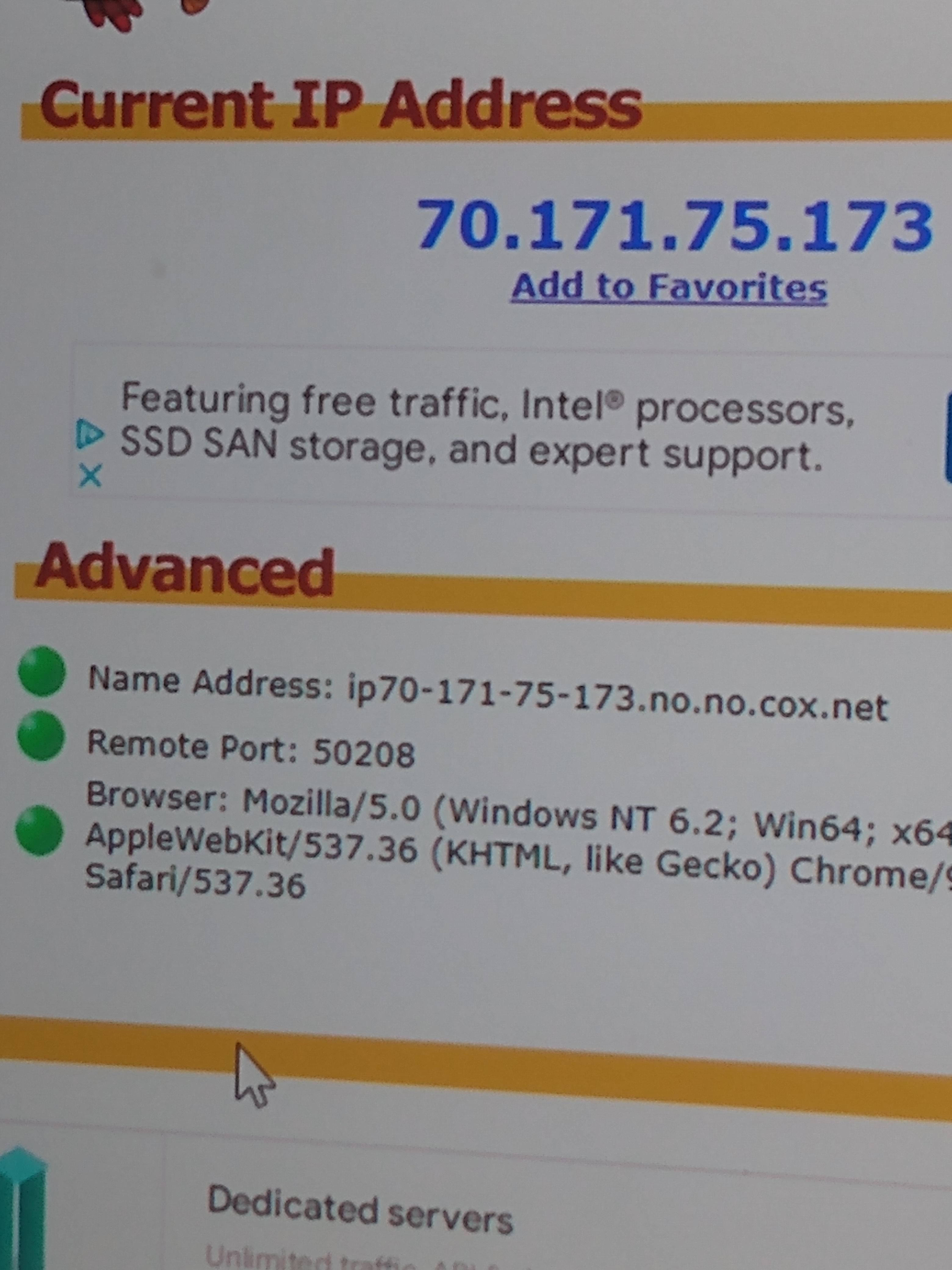

Thanks bear. I am connected from my mud machine wirelessly to the cable modem now. It has a built in wireless router. I will send pictures. When I run my ipconfig it now shows the DNS from my ISP. I know to put that as DNS server in wg3.30 setup. Can you verify? I have my IP here for my cable modem. I have my server IP address as 70.171.75.173. I am reinstalling because my internal IP was changed since I connected from the wireless router and connected directly to the cable modem. Anything in between I'm missing? I'll send pic to your PM.
Re: Trying to open new board
After I put in my numbers in wg setup wizard, why does packaging manager utility put for the domain name: computer.70.171.75.173
Is that the way it's supposed to be set up? Does it set that for you and it works? My host name is computer. Also in the picture it says name address do I need that.

I can't connect still. The "computer" thing is just WG trying to be clever. Altho WG should only know about your internal IP and not external. So in WG setup set up the internal IP as the address. If your IP changes internally you will have to re-run WG setup to change it.
So to back up some, if your able to play locally with your local IP, then WG is setup and working don't touch. The rest of the work that is needed will be in your router firmware. One concerns me is you keep talking about 2 different routers. Chaining routers can be bad. And you will have a hard time with NAT.
From how I see the layout is: External router(70.171.75.173) -> Wireless router(192.168.1.?) -> WG host(192.168.1.107)
Is this is the layout? If so then you will have to port forward thru both routers.
