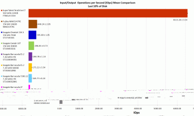

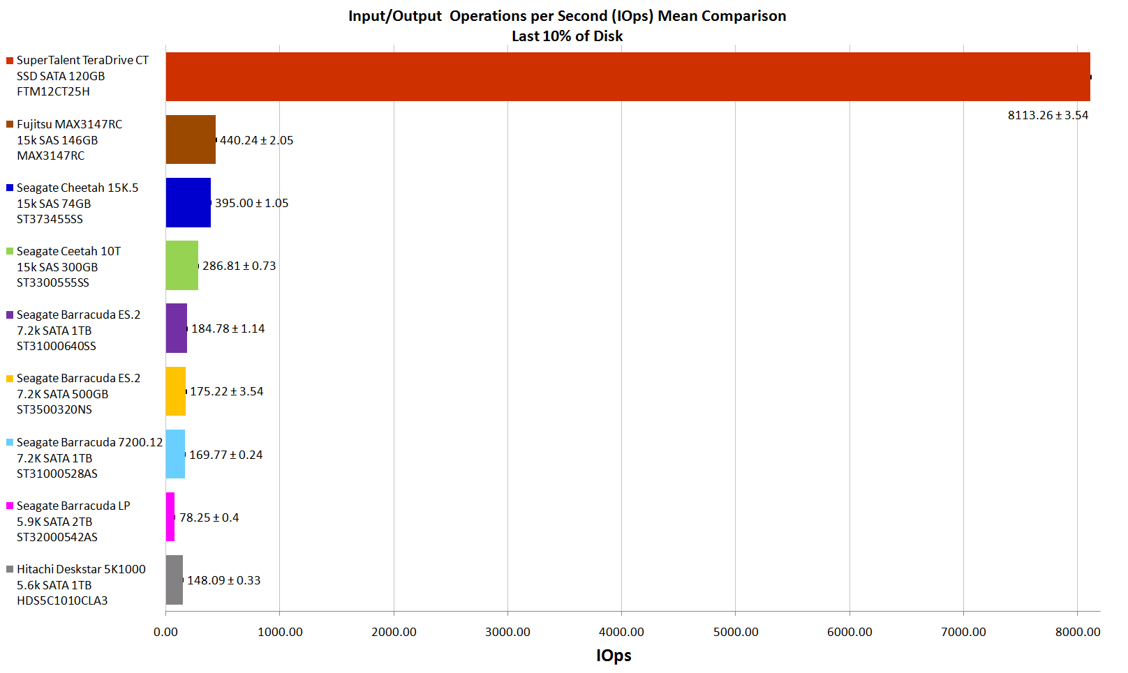

If I say something is twice as fast, yea that sounds awesome, let alone 11 times faster. However, taking the whole picture in, where CPU has increased from 150MHz in 1996 to 4.4GHz (30x) and you also have the additional cores, threads, etc etc and RAM performance has increased from SDRAM at 100MHz in 1996 to DDR4 now running at 4,266MHz (42x) and also now utilizes multi-pathing and such, 11x doesn't sound like much.
It's also hard to compare performance gains between things that aren't of much relation to each other, so really all of these #x are kind of meaningless. But the point I'm trying to make is CPU and RAM (and video cards, actually) have made great strides in different areas to improve performance. Spinning disks haven't in any area other than capacity. There is "more" capacity, "more" cache, "more" speed, but nothing different. Until SSD's anyway.
I've been building computers on a annual basis, for the most part, since I was 15 (20 years ago) and I have always felt like hard drives have been the bottleneck in terms of "general computer usage" speed (e.g. boot time, opening programs, installing, copying/writing/moving files, etc etc). I'd build machines with 7200rpm high-cache dual-hard drives in raid-0 just to get the best performance, and it still sucked watching that blinking hard drive light time after time again waiting for shit to happen. It wasn't until the era of SSDs that the game really changed in the ways that it has changed for CPU, RAM, and video cards over the years.
Take a look at this graphic. The bottom rows are all spinning disks ranging from 5k drives to 15k drives. Look how little difference there is. A 7.2k drive has 35% more IOPs than the 5k, and the 15k has 64% more, but the SSD is over 10,000% more. So yea, I stand by my statements.
edit: forgot to post graphic ><
