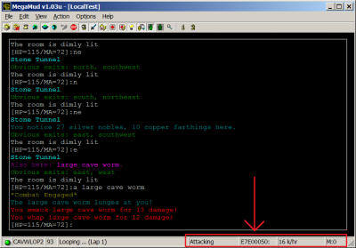

I've created a MegaMud hack that displays the hash code for the current room on the status bar. I've never seen this displayed anywhere in the program, but is important to know because it is used in all the MegaMud paths. It's nice to know the current room hash when manually editing paths. Ignore the trailing colon on the code.
The status bar sizing and placement is tweaked. The room code is placed where the exp rate was, the exp rate is placed where the mana/kai regen was, and the mana/kai regen is placed over the clock. I increased the size of the status bar parts. I use a slightly larger font on my computer and the text on the status bar was being truncated. The Mana/Kai regen section is always displayed now, even when not being used by a class (would be hidden before). All edits are done on the MegaMud.exe:

Nice our first hexedit for megamud. And an interesting one. I'm not sure if I need it but I can see the need for some of my users who love making mega paths.
