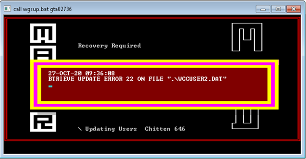

Hi all, thanks to the Phoenix Project I got my WG 3.3 upgrade and 256 user pack, so I grabbed one of my WG 2.0 backups with MUD 1.11b installed from back in the day and went thru the upgrade exercise and all worked fine from 2.0 to 3.3 and MUD upgrade from 1.11b to 1.11g, but when I apply the 1.11p update I get the following Btrieve error, I do want to retain all the accounts for the BBS and MUD.
Thanks Tarkus.
Has anyone come across this error before and know a fix or is it because you cant go from 1.11g to 1.11p in one jump, is there some other updates I need apply in between and if so where can I get the in between versions.Thanks Tarkus.

Re: Setting up a new board
I remember from back in the day, you didn't jump versions. You had to go thru each patch.
Thanks BearFather for the reply, do you know where I can download any of the previous versions prior to 1.11p? I'm scouring the Net as I'm typing this message but with no luck.
I know mudcenral used to have them listed. Might try there first. But ftp sites like major . butt . care, might be your best bet.
Hi, I found some MajorMud version updates at this site,
https://archives.scovetta.com/pub/BBS/b ... qDv6H9wnhM
It comes up with a unsecure site warning, so I used a VM to go there and scanned the files, seems ok, but I haven't done the upgrades yet, let you know how I go.
Hi, just an update, got all I need from the site I listed in my previous post, my test BBS is now running 1.11n, Mod9 and kept my existing user base and Mud environment, I'll let that run for awhile before I get to 1.11p.
