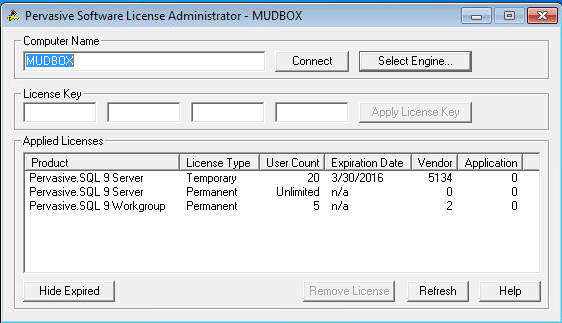

I do have a question/issue though that perhaps someone can help with:
I did the migration from Btrieve over to Pervasive pSQL v9, with the 9.52 hotfix. I found a license somewhere but in the License utility it displays as "Workgroup". I'm pretty sure this is different from the key I'll need since I installed the Windows server version of it. Anyone able to clarify and maybe point me in the right direction for that key? I saw it referenced above; didn't see the key.

I can't remember, but I fired up my old box and this is what it has:
According to this, it may not matter: http://www.goldstarsoftware.com/PSQL-wo ... server.asp
Seems like the workgroup and server are both engines, workgroup just has less capabilities (5 users max, no 64-bit, etc). None of which I think will matter for mmud.

Awesome, thanks for the reply. Worst case scenario, after the 30 day trial for the server runs out I start getting errors and then work from there. :)

Well it's been 30 days and the Btrieve error 161 of doom showed up. Apparently the workgroup license isn't hacking whatever I'm doing. Permanent server key seems to be the key..
