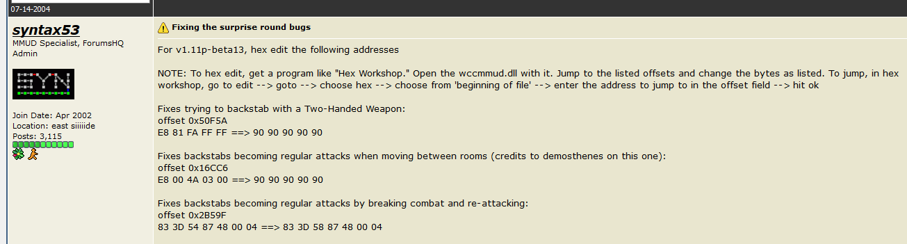

Regarding the surprise round bug, I just found this post I made back in 2004--
Fixes trying to backstab with a Two-Handed Weapon:
offset 0x50F5A
E8 81 FA FF FF ==> 90 90 90 90 90
Fixes backstabs becoming regular attacks when moving between rooms (credits to demosthenes on this one):
offset 0x16CC6
E8 00 4A 03 00 ==> 90 90 90 90 90
Fixes backstabs becoming regular attacks by breaking combat and re-attacking:
offset 0x2B59F
83 3D 54 87 48 00 04 ==> 83 3D 58 87 48 00 04
https://web.archive.org/web/20081030000 ... php?t=8034
