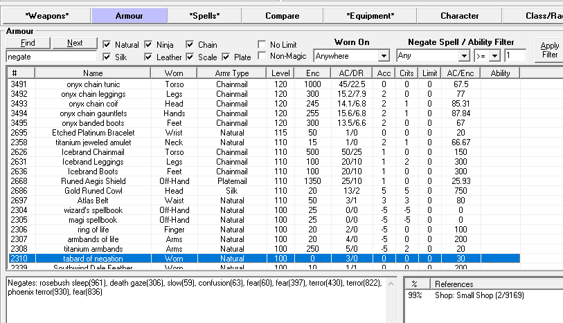

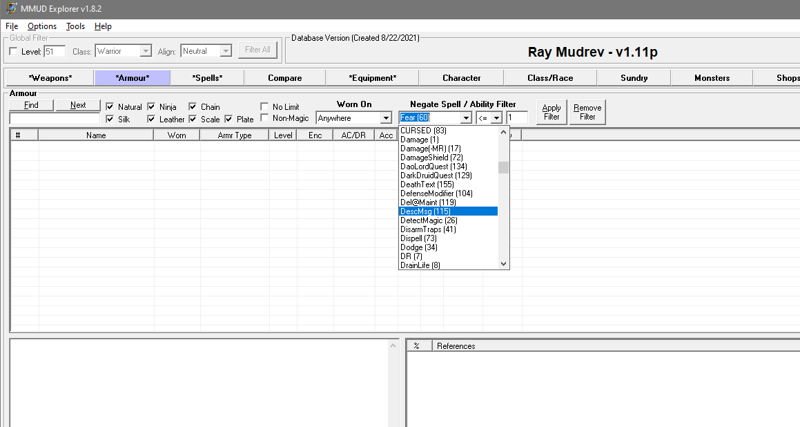

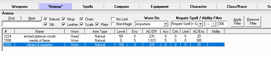

I'm on a mudrev board, and trying to find items which negate pink bunny death gaze (abil 306).
It doesn't show in the abilities that I can negate, but there are definitely items which have it. How can I find said items with MME?
See attachments. First one has no ability to select for death gaze, and second one shows there are definitely items negating it.

if i recall correctly there is a circlet that negates death gaze in mudrev

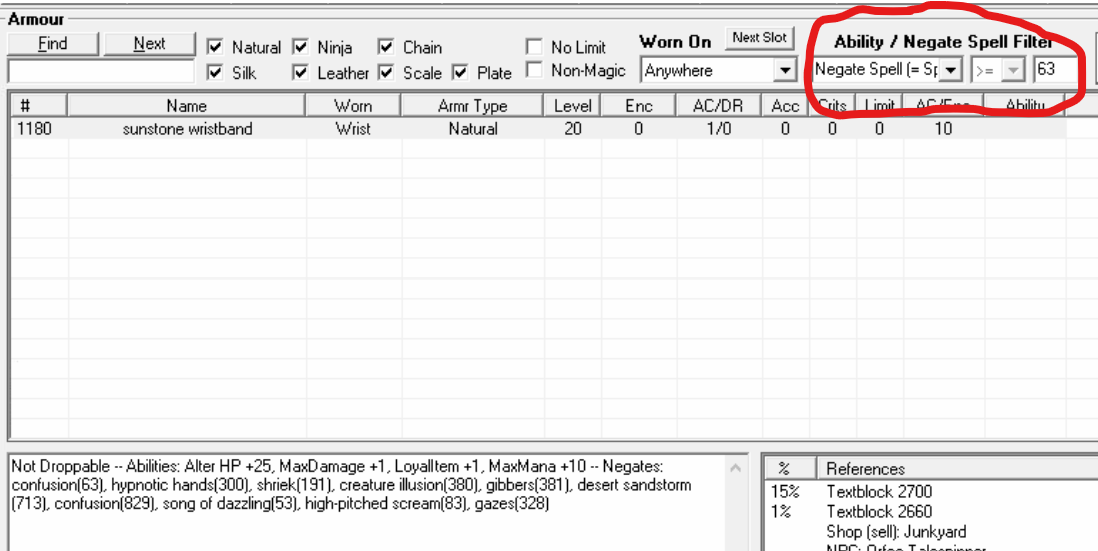

syntax wrote: Thu Sep 16, 2021 8:14 pm You have to choose the negate spell option from the ability drop down and then enter the spell number in the value.
The spell doesn't show up as an option. It's death gaze (306). Does the ability list in that drop down only go up to 200?
Posts: 553
Re: Find items which negate an ability?
No. You choose negate spell from the drop down and enter the spell number in the value. Like this--

What am I missing??
Raybdbomb
Posts: 29
Joined: Wed Oct 24, 2012 1:53 pm
Post by Raybdbomb »
Not sure what I did differently -- I just tried it again and it worked. Ok thanks!

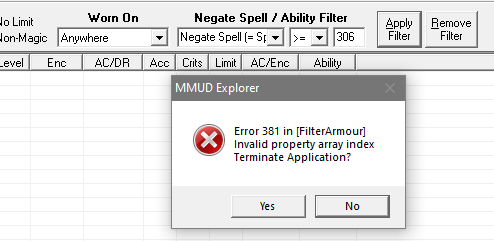

Can't get this working again. Trying to negate 443 and it's saying
Error 381 in [FilterArmour] Invalid property array index
Terminate Application?
All I set is Negate Spell >= 443
Posts: 553
There's obviously a bug in the code somewhere but it must be depending on certain options being selected or other factors. Can you try to play around with removing filters, disabling global filter, changing class, etc, and see what may break/fix it? If it's doing it all the time and you can't not do it, send me the DB and character mmec file.
