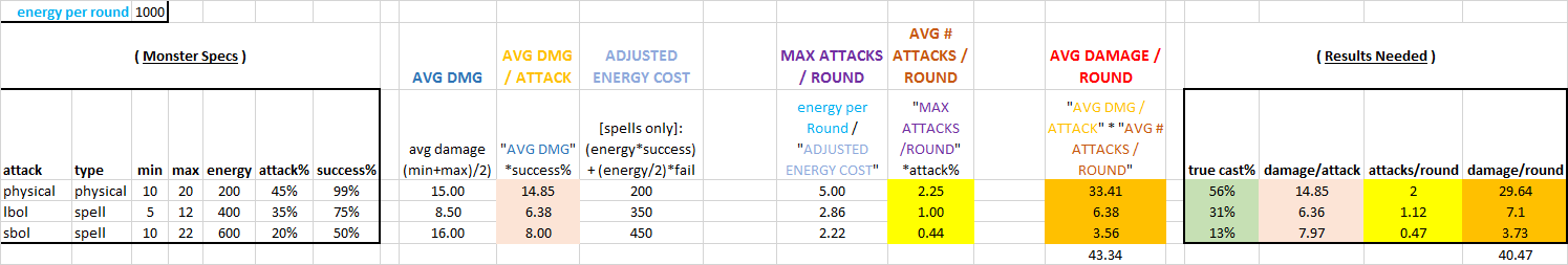

I'm very close, but there needs to be something that adjusts the "AVG # ATTACKS / ROUND" based on the chance the attack has to go off (based off the chance of energy getting used by other attacks and being available or not). Excel file attached / google sheet link available if anyone wants to waste time plugging numbers!
Google Sheet: https://docs.google.com/spreadsheets/d/ ... sp=sharing
mon attack formulas.xlsx
(12.34 KiB) Downloaded 638 times

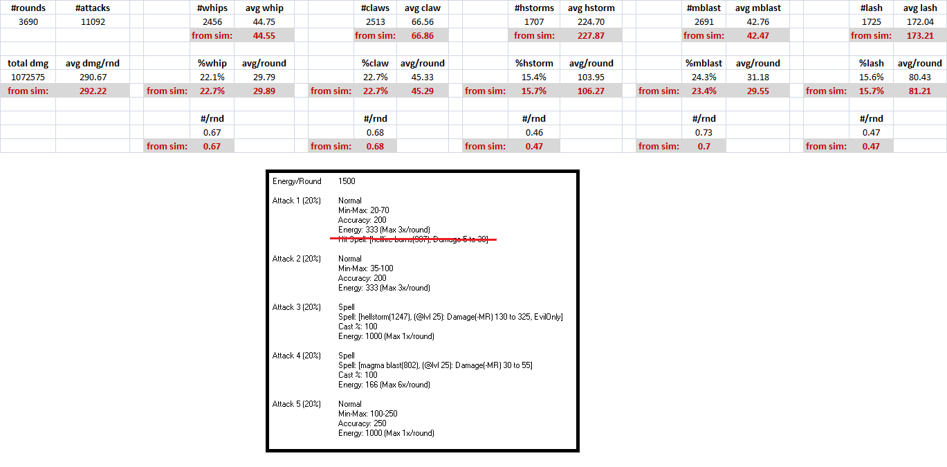

syntax wrote:I'm trying to figure out a formula for MME/NMR that will enable me to easily figure out and display a monster's average damage/round, max damage/round (much easier), and true cast % of each attack. Hoping there may be a math nerd to help me out...
  • I figured out that a monster tries to attack up to 6 times a round.
  • Each of those 6 times is an independent check to see if it will use that attack, based on the attack % in the dats.
  • Then, once it choose an attack, it sees if it has the energy to do it. If it doesn't we move on to the attack attempt out of the 6 attempts.
  • If it does have the energy, it attempts to do it.
    • If it's a "normal" (physical) attack it will attempt to hit the defender, and based on the monster's attack Accuracy vs the defender's AC/dodge it will either hit or miss. I'm also working on being able to incorporate that if I can figure out the calculations on that (RE: this thread) but I'm more worried about getting this formula figured out first. The important thing here with the physical attack is that no matter if it misses or hits (I assume dodge too but I didn't test it) no energy is returned. So a normal attack always uses its full energy.
    • If it's a spell attack, it has a chance to cast or fail based on the attack's cast percentage. If it fails, half the energy is returned.
    • We then move on to the next of the 6 attack attempts.
  • Once the 6 attempts are exhausted, there is 0 energy (or not enough energy for any of the attacks probably), the remaining energy is added to the next round's energy pool.
Update on this for anyone who cares. I spent many hours debugging the DLL in realtime yesterday and finally found a key piece to this. At the end of a "normal" attack (e.g. not a spell), there is a a check to see if there is enough remaining energy to repeat that attack. If there isn't, then the loop of 6 attacks quits out and the monster is done attacking for that round. With this information my simulator now lines up appropriately.
